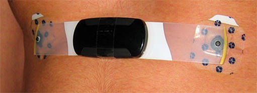

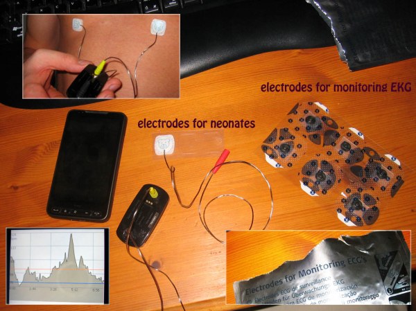

Rouven 10.01.2010 12:31:46 UTC geändert am 10.01.2010 12:37:06 UTC
Hi all,
just did an short test yesterday, to see if the "lock" is still there.
Nothing, but the next runs will show if its right ;)
On the picture you see the electrodes.
For this test i used the small electrodes for neonates.
The cheaper EKG electrodes have the same contact as the HxM,
therefore i need an cable to connect them both.
(I need to find an EKG cable with this "press knobs" like at the belt or the docking station from the HxM)
Its a really nice "free" feeling with this electrodes. No pressure around your body, no down sliding belt ...
Now one question about the cadence.
Is the cadence the sum of all axes? so i can put the HxM it in my pocket without any "right" direction?
If there are more questions, just ask me.
Regards
Rouven
[1]Electrodes for EKG
gmngueko 09.01.2010 20:21:04 UTC
good news
that's a good news but indeed we need to see if this hold in a long term.
what do you mean precisely with "electrodes for EKG" ? is "electrodes" some brand of gel ?
thanks
Rouven 09.01.2010 15:58:10 UTC geändert am 10.01.2010 19:43:44 UTC
Today i made a nice test.
I tested the Hxm with electrodes for EKG use.
EDIT: the problem with the lock is still there
I will upload some photos for you later this day, or perhaps tonight.
Now i love the HxM again ;)
Rouven
