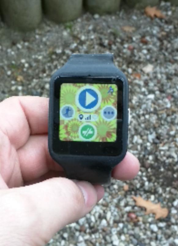

Well, I have installed the latest version (3.2.0) now.
After switching to outdoor mode, the small icon in the middle appeared as you said before.
Strength of signal can be seen. After pressing the start-button nothing happened.
And then I got this moment that is known in german as "der Knoten löste sich", suddenly everything does make sense:
When switching to Outdoor-mode on my Smartwatch, the App runs stand-alone _without_ RUNGPS on my phone.
That's the reason why the START-button on the phone doesn't change when pressing START on my watch.
It does work this way. After you change to Outdoor Mode, a small icon appears in the middle of the screen showing GPS signal strength. You should then go outside and wait for the signal to be good. This may take a bit longer compared to using GPS on the phone.
