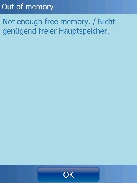

Well, you mean everytime i wanna use this program, i should restart my device first?

This usually means that there is not enough *constiguous* memory. If you restart the device, it should work. The 2.3.6c build 1961 significantly reduces memory usage.
nin187 04.04.2010 07:48:30 UTC geändert am 04.04.2010 07:55:27 UTC
I'm using latest release of Run.GPS(2.3.6c build 1961) now, but it seems this issue haven't solved yet.
It constantly says 'not enough memory' even my device has lots of free memory. :(
Hope to see the new release soon.

admin 27.10.2009 15:05:40 UTC
This happens when you don't have enough free memory to allocate several pages which all have the size of the full screen in one block. You need one big block of free memory.
This may help:
- use the latest version of Run.GPS (2.3.3)
- reboot the device

Run.GPS used to work fine on my Touch Diamond 2 but now it doesn't run. When its launched it just shows that memory is low and shuts down. My device shows plenty of memory for storage and programs.
