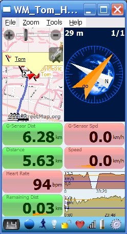

Today I did a test running with GPS and G-Sensor. You can see the results below. G-Sensor recorded 11 % more distance than GPS (which we assume is the real distance).
One thing I think is important to mention because some might not have realized it: The value "G-Sensor distance" is NOT counted for a training session, it is the TOTAL distance recorded since the application was started and the HxM connected.
I'll do more testing with bike etc.

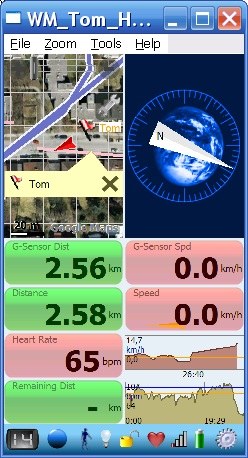

I did another test with the HxM today (walking 2.6 km) and it was a perfect match! GPS said 2.58 and HxM said 2.56 km. We need to find out under which conditions the results are worse.
The test was done with a Touch HD with internal GPS and a Zephyr HxM. You can see the training data here:
http://www.gps-sport.net/trainings/_193394
(but without HxM distance data as this is not uploaded).
To compare HxM and GPS accuracy, you can easily configure yourself a screen showing these values:
- Distance (coming from GPS if the GPS is on and signal is ok)
- G-Sensor Distance (coming from HxM)
- Speed
- G-Sensor Speed
[1]Screen configured for comparing G-Sensor and GPS data
