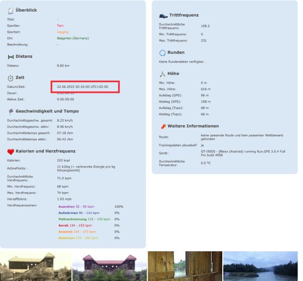

New releases of Run.GPS (Android, Blackberry, iOS, Windows Phone) will send additional timezone information to GPS-Sport.net. It's already wired on our server and you can recognize such uploads by the timezone added behind the time / date field (see below). (As for now, this is only possible with our beta versions, of course.)
[1]Timezone added to training start time / date field
