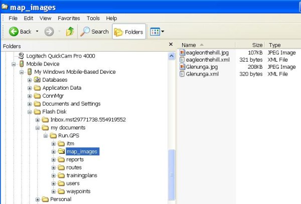

I have found the illusive directories and files!!!
There is an internal "Flash Drive" (non-removable) that I was unaware of and that is where all the information has been stored.
I now have maps!!!!! Hurray !!

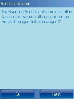

Tom 10.04.2008 08:39:37 UTC
Hi Frank
that directory must exist somewhere because *everything* is stored there: placemarks, training recordings, the configuration, exports, reports, ... If it didn't exist at all, the application would not be able to start. Maybe your device has two memory/storage cards. Some devices declare a part of their built-in memory as storage card.
Try the following:

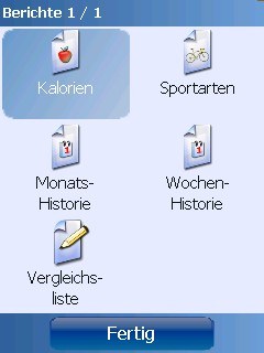

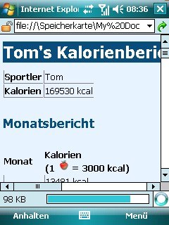

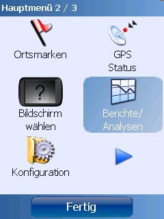

1) Main Menu > Reports
2) Calories Report
3) Anwer no (changing time range)
4) Now you can see the data directory in Internet Explorer address line
Cheers

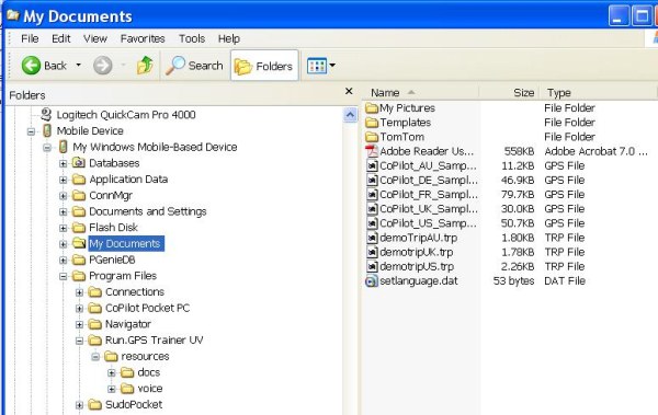

faargus 10.04.2008 02:12:21 UTC geändert am 10.04.2008 02:23:45 UTC
Hello Tom

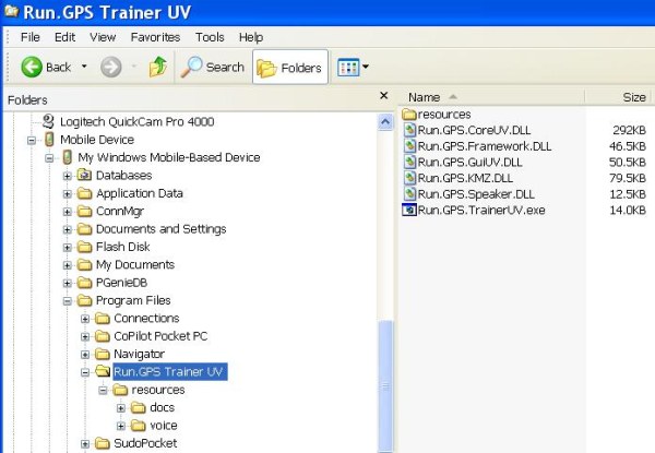

I decided to completely remove the programs (including Microsoft.NET) from the Desktop and Mobile computers and to reinstall them all again.
I can see the "Run.GPS Trainer UV" directory plus 6 files and a sub directory "resources" on My Device under "Program Files".
However in "My Documents" there is no directory for "Run.GPS" nor is there one in "My Documents" on the SD-Card.
What is the next step?
Cheers
Frank

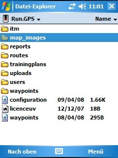

robert 09.04.2008 11:04:23 UTC
Hi Frank
the directory must be named "map_images" (plural). Did you find "map_image" somewhere in the documentation or is it a typing mistake?
The location is "\My Documents\Run.GPS\" or "\SD-Card\My Documents\Run.GPS" (name of the SD card may vary).
The dir must look like in screenshot [1] and is created by Run.GPS.
Cheers
[1]Run.GPS folder
