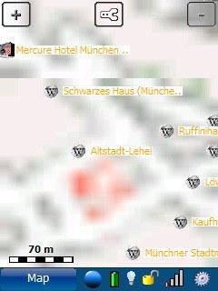

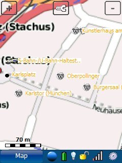

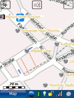

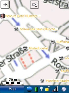

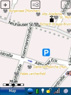

We will grant one higher zoom level with version 2.2.5 appearing today. The zoom levels will be
OpenStreetMap: up to 16 (max zoom has been 15 in the 2.2.4)
OpenPisteMap: up to 15
Cycle Map: up to 13 (sorry Cycle Map doesn't support more at the moment)
We think that the OpenStreetMap zoom level is now enough for cities and outside regions, but the Cycle Map zoom level sure could be improved. We'll see what can be done in the future.
[1]OSM
[2]OSM
[3]OSM

Openstreetmap Tiles will only be loaded up to zoom level "16" (...\map_images\osm\16\*). This is fair enough for outer regions but in large cities some relevant information (street-names, POIs, ...) are missing in this level.
Also in the Run.GPS Map-Window there is a zoom level missing between 70m and 200m.
