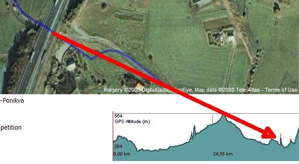

Tom 04.08.2008 09:14:11 UTC
The altitude smoothing buffer already acts as a (low-pass) filter which filters out any fast changes in altitude. If we'd add an additional filter that might be a problem in the following case: if GPS first detects wrong altitude and needs to adapt quickly to the correct altitude. If we were to add an additional filter this process might take too long (minutes).
Bosti 03.08.2008 23:34:38 UTC geändert am 03.08.2008 23:37:20 UTC
I have te same problem; with bike in the tunnel, for example. Near tunnel of highway.. http://www.gps-sport.net/trainings/Vitanje-Slovenske-Konjice-Ponikva_35350 - position is quite good, altitude is bad.
What about this solution: add a limit how much can altitude and position change in 10 seconds... and filter it.
