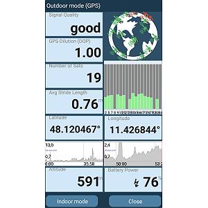

For this to work correctly, you first need to figure out your stride length on your phone:
- Record an outdoor running or walking activity
- Open „mode dialog“ (GPS symbol in control bar) – there you'll find the calculated stride length
- Enter the stride length in Main Menu >> Configuration >> Android Wear (you can enter separate values for running and walking activities)
