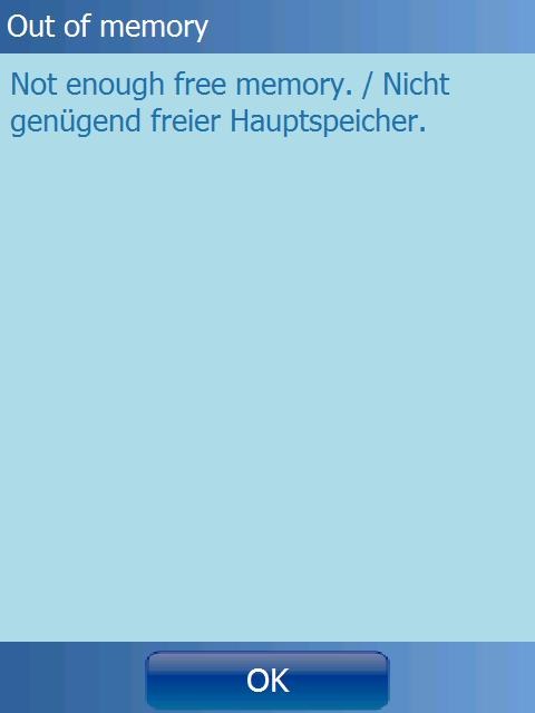

rotations caused application closeing problem
Hi,
I used to have a problem with RunGps application. Sometimes, without reason (in my humble opinion of course) application close with feedback "Out of memory" Not enough free memory - Nicht genugend freier Hauptspeicher", like below.
It was quite strange for me, becose I was very carefully with memory usage - no others application in run, no smses, conetion incomeing etc., plus even some applications cleaning ram (oxios and cleanRam). Effect - more than 30mb ram free. And this problem still sometimes occur.
I've decided to check it very carefully and I thing I got it! Screen rotation program caused problem - I've noticed that if I take phone in my hand and started to rotation it (vertical and horizontal with few secounds gap all around) afther about 1 minute application crash like I've described above. Of cours I've got rotation application instaled in my htc diamond wiht makes screen rotation depends on how phones is oriented.
There are some solution of this problem I've figured out:
- uninstall additional screen rotating application
- define exeption (if possible, depends on application) in such application for runGps
- run runGps program in backgound (not on 'the top'), for example switch to today screen
I hope You'll find my description usefull, also it could be a hint for programer for correction in next release.
Greetings for all gpsRun users, especially from Poland! ;-)
